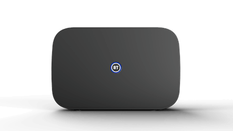

Your Smart Hub 3

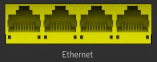

A block of 4 Ethernet ports..
Ethernet ports
4 ports: Connects to your devices.
