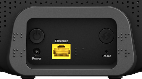

Connectors, ports and buttons on the rear of the BT Complete Wi-Fi Plus
Power button: To turn the device on and off.
Round push buttonWireless (WPS) button: To connect devices wirelessly.
a small round hole. The power supply cable plugs into itPower connector
An Ethernet port, you can use this to connect devices by Ethernet Ethernet port: Connects to your devices.
Small pinhole buttonReset button: Reset to factory default

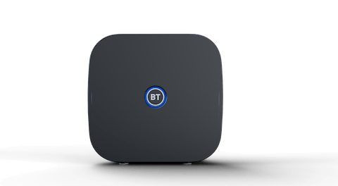

What the lights on your Complete Wi-Fi Plus mean
Light
What it means
image of green light
Solid green
Your Complete Wi Fi Plus is starting up
Leave your Complete Wi Fi Plus to start up.
It should take approximately 60 seconds to fully turn on before it attempts to connect.
image of flashing blue light
Flashing blue
Your Complete Wi Fi Plus is connecting
WPS has been activated and is connecting to your hub or device.
This could take a couple of minutes.
image of flashing orange light
Flashing orange
Your Complete Wi Fi Plus is not connected to your hub
Follow the instructions to connect using WPS, or
You can use an Ethernet connection.
image of orange light
Solid orange
Your Complete Wi Fi Plus is working OK
Your Wi-Fi Plus is connected, but trying to connect to the hub on another Complete Wi-Fi Plus to improve the connection.
image of blue light
Solid blue
Your Wi Fi Plus is all connected and working properly
Your Complete Wi-Fi Plus has a reliable Wi-Fi or Ethernet connection and is working well.
image of no light
No light
The power is off, or the lights have been turned off
Check that the Extender is plugged in, switched on, and its lights haven’t been turned off in the Hub Manager.
